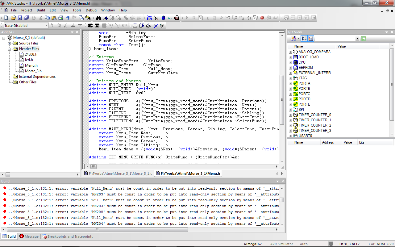

V priloze je obrazek z prekladu.

Pri prekladu to hlasi toto
../Menu.h:34:25: error: variable 'Null_Menu' must be const in order to be put into read-only section by means of '__attribute__((progmem))' ../Morse_3_1.c:120:1: error: variable 'MN200' must be const in order to be put into read-only section by means of '__attribute__((progmem))' ../Morse_3_1.c:120:1: error: variable 'Null_Menu' must be const in order to be put into read-only section by means of '__attribute__((progmem))' ../Morse_3_1.c:120:1: error: variable 'Null_Menu' must be const in order to be put into read-only section by means of '__attribute__((progmem))' ../Morse_3_1.c:120:1: error: variable 'MN101' must be const in order to be put into read-only section by means of '__attribute__((progmem))' ../Morse_3_1.c:120:1: error: variable 'MN100' must be const in order to be put into read-only section by means of '__attribute__((progmem))'
Kod moc nechapu, takze jsem zkusil zmenit extern za const, ale potom to pise toto
../Morse_3_1.c:120:1: error: variable 'MN100' must be const in order to be put into read-only section by means of '__attribute__((progmem))' ../Morse_3_1.c:122:1: error: conflicting type qualifiers for 'MN100' ../Morse_3_1.c:120:1: note: previous definition of 'MN100' was here ../Morse_3_1.c:122:1: error: variable 'MN101' must be const in order to be put into read-only section by means of '__attribute__((progmem))' ../Morse_3_1.c:122:1: error: conflicting type qualifiers for 'MN101' ../Morse_3_1.c:120:1: note: previous declaration of 'MN101' was here
